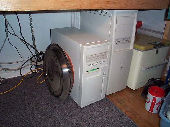

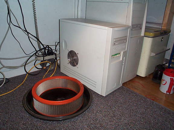

I've got it!!! Get an Inwin Q500 full-tower case, and seal up all the holes in it with aluminum ducting tape. Use a sheetmetal blade in an electric jigsaw to cut a blowhole for a 120mm fan on the side panel and a blowhole for an 80mm fan on the top panel. Go to an automotive wrecking yard, hunt down the top cap from the air-cleaner assembly of a GM V8 engine (look for a Chevy Impala or Caprice Classic, or equivalent car).
Now drill a 1/4" hole close to the edge of the blowhole on the side panel. Find a bolt long enough to hold the appropriate size of Fram automotive air filter to the side of the case with the air-cleaner cap you got. Since all the vent holes are sealed, all the air going into the case will be pulled through the air filter by the 120mm fan. Restriction should not be a problem, since those filters can handle hundreds of CFM. You can change the air filter every month or two for about $4.
With a Panaflo L1A 120mm fan, you would have about 65 cfm entering the case from the side, and if you put an L1A on the top as an exhaust blowhole, the exhaust fans should be slightly less powerful than the intake fan, resulting in a tendency for air to come out any small holes you missed, keeping paint and dust out. If the side blowhole is centered at the level of the AGP card, it will cool both the cards and the CPU. The Panaflo L1A models are low-rpm fans that most people find tolerable for overall noise levels. You can find them at Teamawe and CaseEtc among others. If noise is not an issue, there are much more-powerful 120mm fans you could use in place of the Panaflo.
Just for the heck of it, here are two pics to illustrate the air-filter idea. They're hosted on Tripod, so you will have to click a follow-through link to view them.
Pic of my S500 and the air cleaner off my car
Air cleaner on side panel, covering the blowhole
You might consider an S500 as a good alternative to the Q500 (the taller case in the pics is my old Q600, which is a Q500 with an alternate bezel style). The S500 is less expensive and you could simply put the 80mm exhaust fan in the provided spot on the rear panel, and cut a blowhole on the side for the intake as I did. The Enlight 7237 is another good one, very similar to the S500 in overall features. The material is a bit lighter. You can pick up the Enlight without a power supply if you want to pick your own power supply. Russ happens to carry the 7273 with the Enermax 330W "whisper" power supply at CompuCheap, look under Components>Misc. For an S500, Directron.com might be a good place because they'll let you substitute power supplies. Hope that is a help. 🙂
