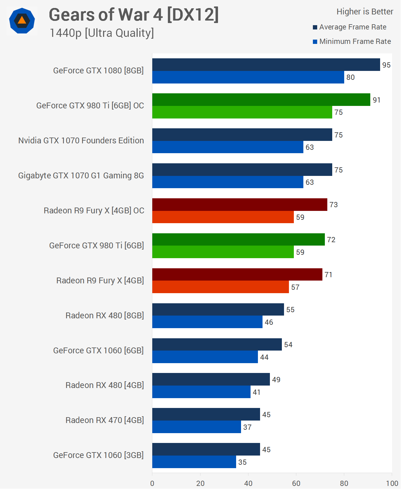

GTX 980Ti OC performance in Gears of War DX12 is nasty...just nasty.

It's an Unreal Engine game, and I don't think it implements DX12 in a way that can really take advantage of AMD cards.
I don't think this is true. Gears of War 4's asynchronous compute implementation has a significant performance increase on AMD hardware, more than what you see in Sniper Elite 4.
The reason for NVidia's exceptional performance in this game is due to the engine being very well optimized for NVAPI.
That's still 10 percent at most in the best-case scenario. Nothing like the 30 percent gains in Doom Vulkan with Shader Intrinsics and Async Compute on GCN.
Doom Vulkan remains the best implementation of these low-level APIs till date.
Moreover, I think that Async compute only alleviates the CPU overhead issue on GCN cards in Gears of War 4.
