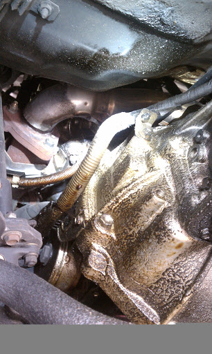

Well, got a real good look at it, and a lot is wrong (that I can tell).
Mmmm, oil. Looks to be the valve cover gasket is shot and that is what is causing the leak.
Next is the left fron tie rod end, its got a lot of play in it (she probably hit something).
After that is all three belts are bad and need replacing, the one for the alternator is the worst looking.
After that the only things that really look bad is the front left tire is half bald and will need to be replaced.
A lot worse than I had thought...great.

i can't tell a lot from your pic, but i would say the GOOD thing i see if that there appears to be a definite oil trail- which means you can fix it. often times, with older cars, the entire bottom half of the motor (along with the trans and front subframe) is covered with oil and grime- can be awful hard to pick out indiviual leaks; and when you do fix them, another one's just going to crop up somewhere else.
