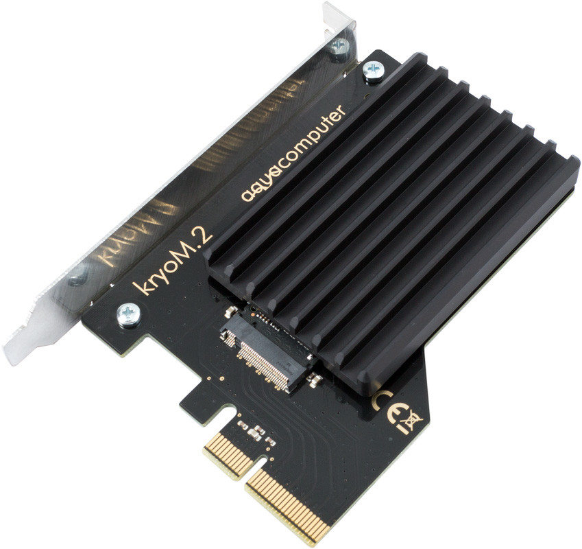

Perhaps devote some tedium, time and attention to case airflow plus installation of something like this?
