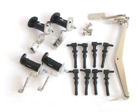

Such a shame the fan is about to go. Was looking at Be Quiet PWM fans but they don't have the right mount holes, then need to be like normal case fan mounts so they can fit the rubber mounts that look like this:
Can anyone suggest a decent quiet PWM fan with at least decent airflow and static pressure but low noise?
