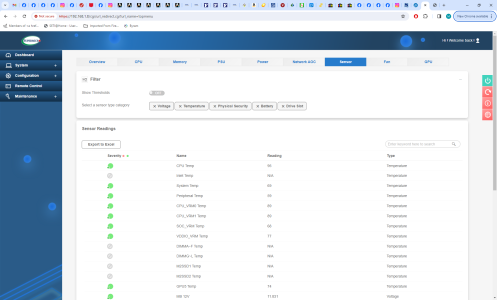

Could it be related to a certain temperature reading bug which affects Windows, starting with SuperMicro BIOS version 1.6?
See Genoa builders thread, #178 and subsequent posts.
Did you cross-reference HWinfo64's readings with the BMC's readings in IPMI?

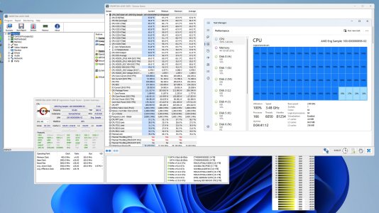

I can't find the IPMI address, so windows is the best I can do. And I have a 4080 running@100% also. Basically 3.5 is the max, and the real temp@93%load is most likely 87c.
Markfw
May 16, 2002
26,129
15,274
It is 95 !!!!

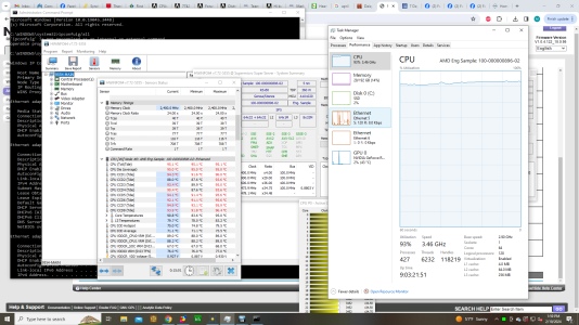

Markfw how is your 9554 doing? I bought the same chip from the same seller and came upon this thread while searching for 100-00000896-02. I see in your hwinfo screenshot the ratio in Avg. Effective Clock is 34.5. I am not able to get anything above 31. The CPU temperatures displayed by HWInfo are all below 70C, yet I see PROCHOT CPU. Did you have to make any changes in the bios settings?
First, I would not take anything seriously from hwinfo64 on a Genoa, not designed for it, or Ryzenmaster.but your effective speed and temps look fine. You should use the built in BMC software (use the special IP port for that, a second connector) it will be accurate for all info, like temps, etc.

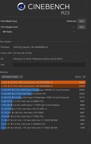

'm using the SMC H13SSL-NT motherboard, and I've noticed that the temperature readings align between HWInfo and the BMC. I conducted a Cinebench test to compare the processor's performance to the figures you previously shared. My score was approximately 15% lower, at 66K. I've only populated 4 out of the 12 memory channels – could that be the reason for the reduced score? This is my first Genoa build, and I want to ensure everything is functioning as intended. I appreciate your insights. I came across this thread today, and it's been an invaluable resource.
4 of 12 channels ? That is a real no-no if you want full performance.
StefanR5R
Dec 10, 2016
5,913
8,820
Wrong PROCHOT readings due to some BIOS versions were discussed somewhere in the Genoa builders thread.
Cinebench wasn't memory bandwidth sensitive in the past, but this changed somewhat with CB 2024.
AMD have a guideline which channels to populate first:
AMD EPYC™ 9004 Series Memory Population Recommendations (PDF)
In a 4-channel configuration, channels A, C, G, and I should be populated. That way, each one of the four quadrants of the IOD will have one active memory controller.
I have populated the same channels after consulting the H13SSL manual. Today, I also ran passmark as it splits the benchmark by CPU, memory etc. The CPU's passmark score was 88,000, while their website has only one 9554 sample score of 110,000. However, 9554P has a few more samples, and they all are in the same neighborhood. My CPU score is 80% of the passmark average score, and this is in line with ratio (my cpu score / MarkFw score). I will run the benchmark after I have the four more DIMM's. The other possible difference I can think is I have SMT disabled in bios. But as far as I understand, that should not matter.
19,823
13,588
That will lower the multithreaded CPU score by about 15 to 25 percent. But enabling it may increase the bandwidth requirements so you need to populate the missing channels to make the most of SMT.

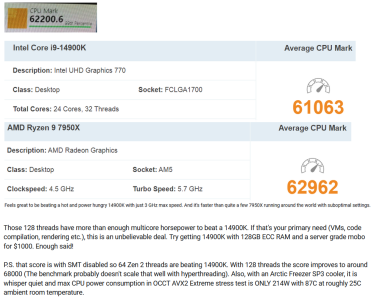

You need to install Windows for Workstation. It shows all my 128 threads on an Epyc 7002 series ES CPU.
You need all cores/threads available and also all memory channels available to see improvement in Passmark score.
Look at my score here: https://forums.anandtech.com/thread...-reduced-and-7742-added.2607772/post-41184279
Beating a 14900K and I bet there are some badly configured 7950X out there in the world that will post a lower Passmark score than mine.
