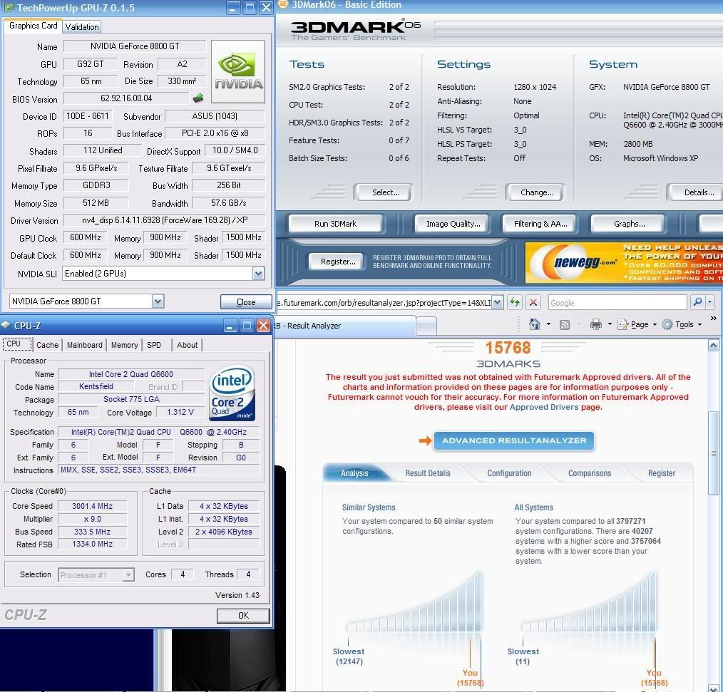

Stock Settings : http://i214.photobucket.com/al.../3DMark06ScoreXP-A.jpg
OC'd Settings : http://i214.photobucket.com/al.../3DMark06ScoreXP-B.jpg
Thanks.
