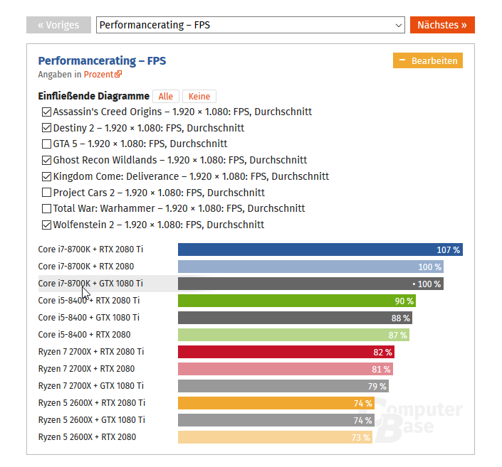

Typical viral marketing from Volker Riska, he published the results even if it s obvious that they dont correlate with their own previous reviews using the same games, word is that it s the Nvidia drivers wich are the culprit...
Anyway to check deeper before talking of those 30% that were 11% not so long ago....
https://www.computerbase.de/2018-04/amd-ryzen-2000-test/4/
So what happened.?...

It's because :
He used a more powerful GPU
he used 6 new different games
He also used savegames instead of on rail benchmarks
The CPU test system relies on the first driver for the RTX 2080 (Ti), the GeForce 411.51, and the eleven games tested have been updated to include new savegames and other test scenarios, which makes them incompatible with previous tests
https://www.computerbase.de/2018-09...e-rtx-2080-ti/#diagramm-performancerating-fps

It's because :
That s not the point and you missed the fact that he was questionned in their forum and so far he gave no explanations as to why the difference increased with previous GPUs, it was 11% difference with a 1080ti here :
And in this new, and dubbious, review it s 26% with this same 1080ti and the same games...
https://www.computerbase.de/forum/attachments/2018-09-26-21_13_03-cpus-von-amd-intel-im-test_-core-i5_i7-ryzen-5_7-mit-geforce-rtx-im-ve-png.711938/
Btw, the games have nothing to do about it since he used them previously, besides the results are not even consistent for Intel since the 8700K has only HT compared to the i5s, but the difference is big, and it should be big as well between the 2600X and the 2700X since the latter benefit from two cores that have way higher throughput than the 2600X s SMT for additional threads, but that s not the case at all..
Edit : Main difference between the two reviews are the Nvidia drivers :
GeForce 391.35
https://www.computerbase.de/2018-04/amd-ryzen-2000-test/3/
GeForce 411.51
https://www.computerbase.de/2018-09/nvidia-geforce-rtx-2080-ti-test/2/

Not only the driver, but the new tests used savegames instead of built in benchmarks, it also used several new CPU heavy games.
Yes that's true. What @Abwx was getting at, was that even in the games included in both, AMD results were significantly worse than before. Even when they used saved games instead of time-demos, it's still a bit odd, Considering how beefy the 2700X is on resources. I've yet to see it tank so much, relatively to the competition, in actual gameplay vs time demos. One would expect the difference to be about the same give-or-take a little.
Case in point: Performance diff 8700K vs 2700X
New Article (1080 Ti results only @ 1080p):
Assassins Creed Origins - Intel: 92.6 FPS, AMD: 77.7 FPS, Diff: 19%
Project Cars 2 - Intel: 116.6 FPS, AMD: 81.5 FPS, Diff: 43%
Kingdom Come Deliverance - Intel: 79.4 FPS, AMD: 64.7 FPS, Diff: 23%
Total War Warhammer - Intel: 62.8 FPS, AMD: 49.1 FPS, Diff: 28%
Old Review (Asus GeForce GTX 1080 Ti Strix @ 1080p):
Assassins Creed Origins - Intel: 98.5 FPS, AMD: 89.6 FPS, Diff: 10%
Project Cars 2 - Intel: 107.2 FPS, AMD: 93.6 FPS, Diff: 15%
Kingdom Come Deliverance - Intel: 78.9 FPS, AMD: 71.0 FPS, Diff: 11%
Total War Warhammer - Intel: 54.7 FPS, AMD: 49.2 FPS, Diff: 11%
AMD has lost ~10FPS in 3/4 games while Intel has gained 10 FPS in 2 out of 4 games, stayed even in one and lost 6 FPS in only in one title.
I don't doubt that these are the results they got, but IMO such profound performance loss on one side, agains a similar net-gain on the other vendor, at least merits a deeper look as to why. Bear in mind the GPU, resolution and games are the same. The only difference is saved-games and drivers.
The most obvious things to test would be:
1) to run the old time-demos on the new rigs (and drivers), to see if there is a difference
2) run the same save-games with old drivers, to see if there is a difference

Abwx
Apr 2, 2011
9,460
1,452
Like I said: Then you're not interested in a CPU test, you're interested in a system test. That's fine, but pretty meaningless if you want to know the performance difference between the CPUs themselves. Just looking at such data could end up with you buying a CPU that's a good deal slower than it appears, which may become apparent if you try to run games with higher CPU requirements (or future games).
The whole point with my post is that there are very obvious reasons for testing at lower resolutions. Honestly, I can't understand how this still seems hard to grasp or "controversial" among some people.
At a lower resolution, that is 720p, and the most demanding scenes of the tested games there s not as much difference than what Computerase got at 1080p..
http://www.pcgameshardware.de/Ryzen-7-2700X-CPU-267374/Tests/vs-8700K-Ryzen-5-2600X-Review-Benchmark-Release-Preis-1254720/
PCGH, 720p, 1080ti
ACO = 2700x zu 8700k = +4%
Kingdom Come Deliverance = 2700x zu 8700k = + 13%
Wolfenstein 2 = 2700x zu 8700k = +11%
Computerbase, 1080p, 1080ti
ACO = 2700x zu 8700k = +19%
Kingdom Come Deliverance = 2700x zu 8700k = + 23%
Wolfenstein 2 = 2700x zu 8700k = +27%
(Courtesy of DonL_ at Computerbase forum..)
CPU limit and difficulty to grasp you said..?
