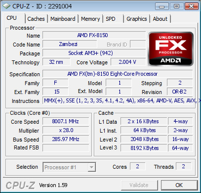

99% true, 8120 and 8150 are the same chip(same module count, same L2, L3 etc) except the higher operating frequency the 8150 has. IPC and performance Clock per Clock are the same.
Only difference i know is with Xtreme OC (LN2 etc), 8150 OC higher. No difference in Air/Water cooling as far as i know.
First Greek OCer at 8GHz (Nickname : AMDnord).
http://valid.canardpc.com/cache/screenshot/2291004.png
http://www.hwbox.gr/news-overclocking-hwbot/15965-mission-8ghz-status-done-amdnord-inside.html
