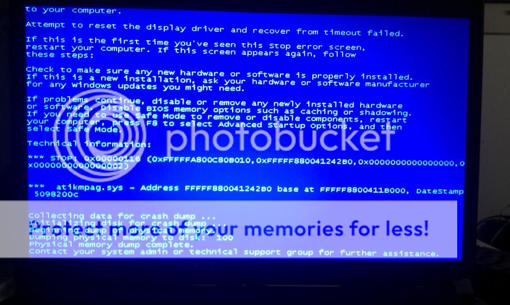

    When I restart:
    Reboots, Windows Loads but can't use mouse or keyboard, few seconds later black screen and nothing happens.
    So I shut off by the power button and start again. Then Windows Loads, cant use mouse of keyboard, Blue Screen http://i680.photobucket.com/albums/vv162/nipplepie/IMAG0284.jpg
    3rd time I got a Black Screen again.
    4th time back to normal, and usually now I just Sleep the laptop instead.
    Guess it's a bad driver? What driver are you using with your 7970M?
