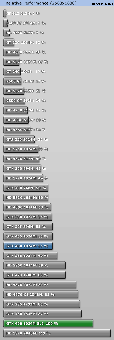

The GTX 460 didn't smoke the GTX285 either.
I think it was BFG10K that had a review where he was annoyed that the GTX460 with exotic AA levels was actually slower.
So I wouldn't be shocked if the GK104 was GTX580 performance levels.

the GTX460 turned out to be as fast if not ~10% faster than the 285 all while consuming ~70-80 less under load
why couldn't the 760 be just as fast if not a tad faster than the 580?
