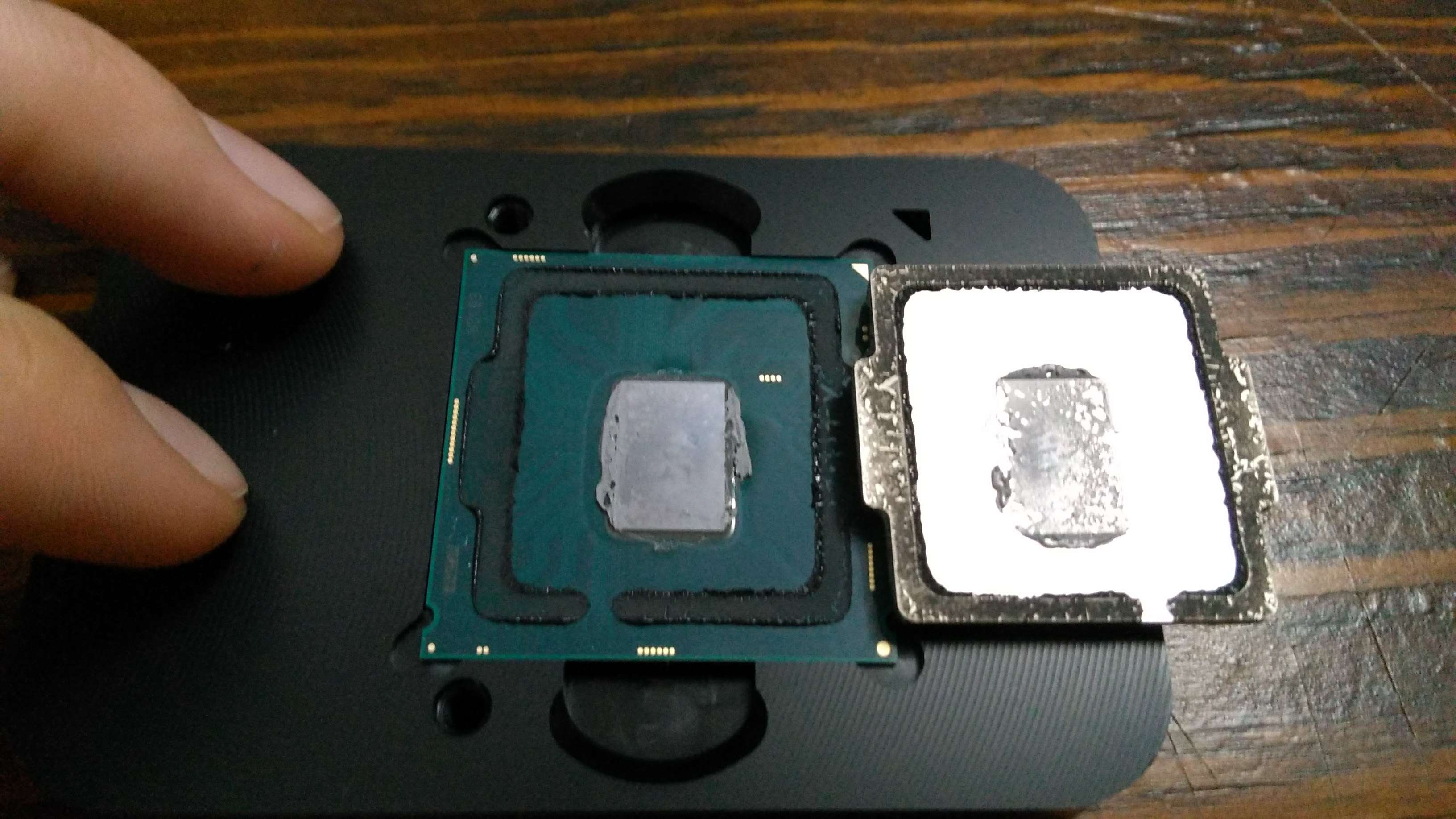

Hi everyone,
This is my first post here, but I have been reading the forum for a long time.
I have delidded my 7700k (with Rockit 88-super easy) due to unacceptable temps even after changing to kraken x61 AIO. Overall improvement I gained is 17C on load (Prime 95 v26.6, small fft, stock voltage and freq). While I am quite happy with the result, I am not sure whether my application of CLU is prone to causing long term issues. I am concerned if air bubbles may have formed. I used a miniscule amount of it, but the spread is far from mirror like.
Can you guys give me your opinion on whether I should redo the procedure or leave it like this?
I am attaching some pictures of the process.

leave it as it is.
I dont see anything wrong with the application.
As u clamp down the IHS again, the bubbles ur worried about will be pushed off to the side so it wont impact much.

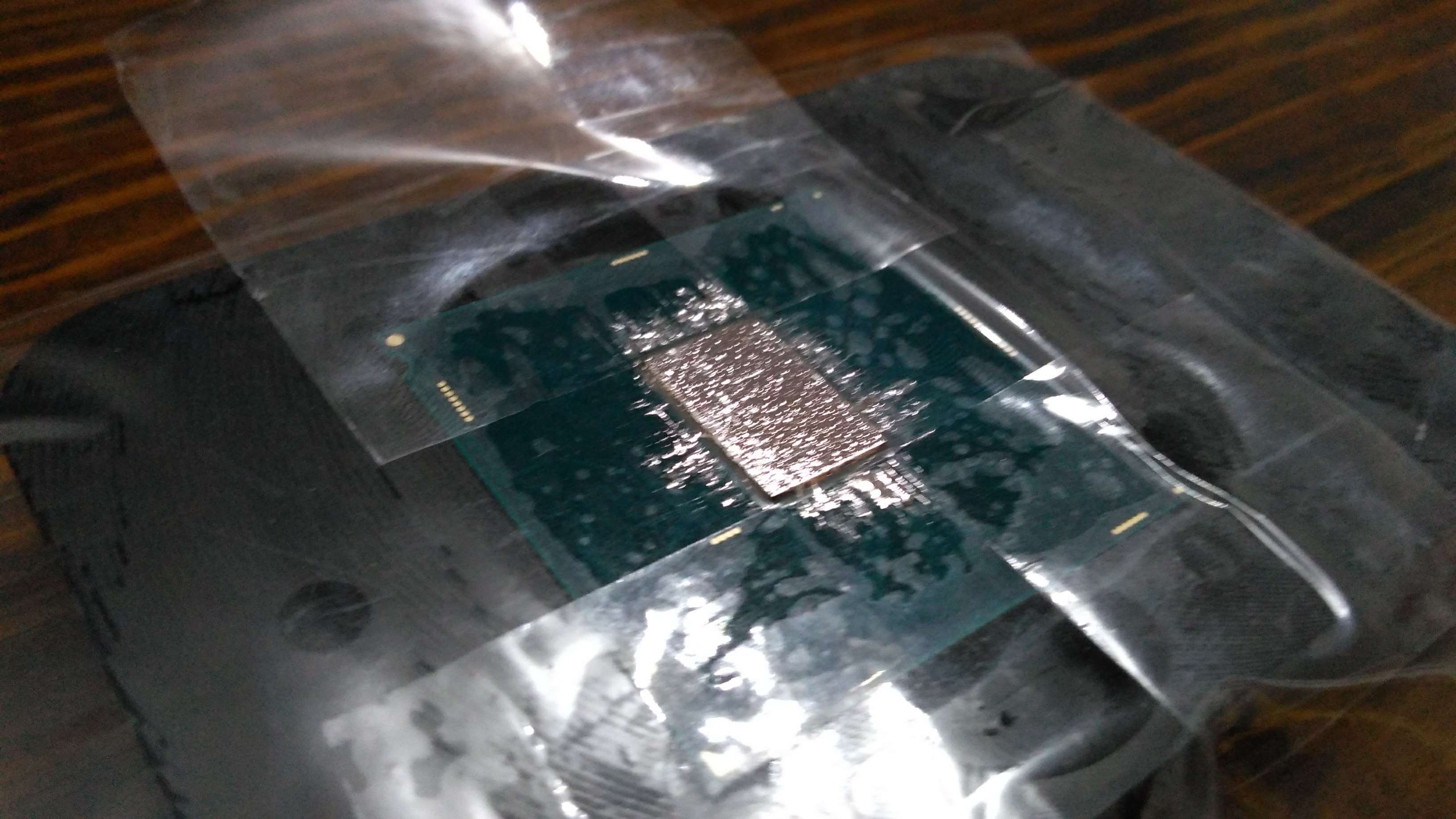

Thx aigomorla, that's good to hear. One more thing: I just realized I didn't protect the row of tiny contacts near the corner of the die with varnish or otherwise. Can this be an issue?

Your application of CLU is absolutely fine. The air bubbles are unavoidable when applying the CLU and when you clamp/compress the IHS back on it will remove any residual air bubbles.
As long as you don't apply too much CLU, you don't have to worry about it seeping out onto the exposed contacts. I never covered the contacts and my 7700k has been running flawlessly at 5.1ghz for over 5 months with no degradation in temps.
