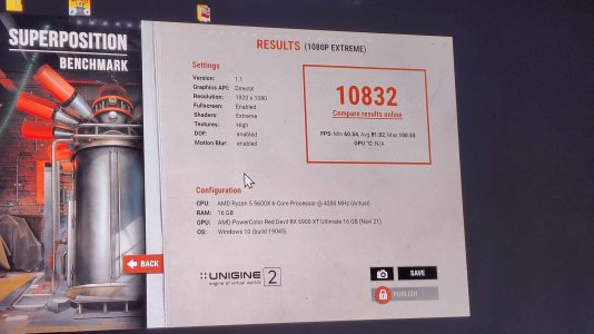

I just ran superposition on mine and my sons rig (3600 non x and 6700xt) and my pc was twice as fast. Guess Im just too darn old school and love me the valley to listen to its music and sweet graphics for I got a average of 142 FPS on it where my son barely got 70 fps. Before I bought my 5600x I youtubed all the cpu's from it on up, and only diff that I could find was it was faster if I did creator stuff, or streamed, but when gaming was lucky to see 4fps better all the way up to a 5900x :O which is why I chose to buy a 5600x for I couldnt see spending more money to gain 4 fps difference or features Id never use. I got a score of 16K and change, my son got 7K and change, so I am happy, thanks for all the input!
And yeah, that was one sweet 6800 being a 6800 Gigabyte Master he just loves the pc I built for him with that card :O

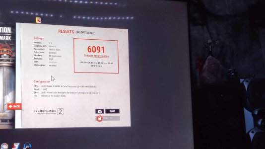

If anyone cares to try......Only setting I have on in my mobo is performance mode, Memory auto overclock, and size bar on, I don't know how to over clock so that's as far as I can do for I'm too scared I may break something and be out for a very long time without my pc :O
Here is 8K
Here is 4K
And here is 1080P EXTREAME!!!!!

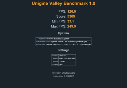

Here is my Valley benches:
2560x1440P
4K
