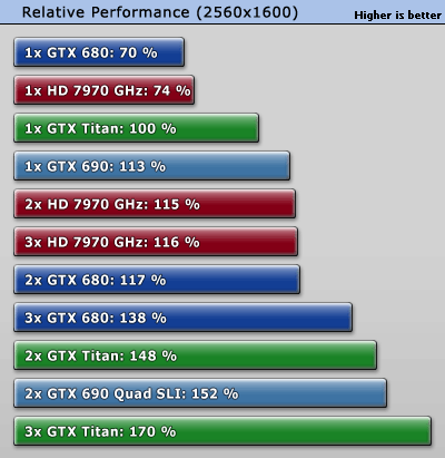

At 5760x1080 two titans will definitely be faster. Made me laugh at linking 1600p benchmarks, the Titans due to the superior memory bus totally destroy GTX 690s at surround resolutions.
GTX 680 GPUs are 1080p monsters, that's about it.
