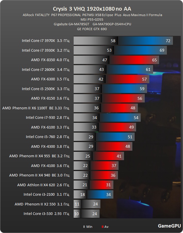

crysis is a bad example though as even when it is cpu limited it seems some levels can only make use of <4 cores while others take a serious hit from only having 4 cores so much so that ht can improve avg fps beyond what its capable of even in rendering
