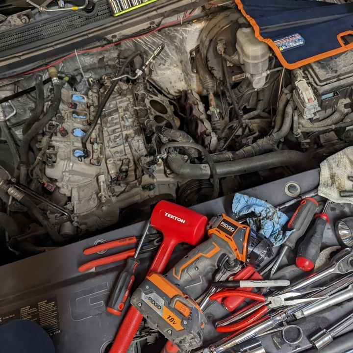

Teardown well begun.

Failed lifter, mildly stuck in the block. Carbon build up on valves is common on DI engines. I'll be putting a catch can on this.
Any advice on cleaning up the gasket surfaces?
