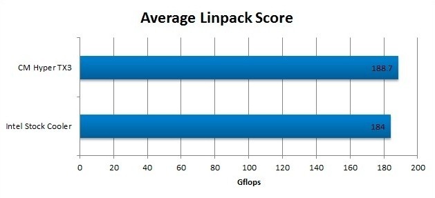

Ya, let's divert the attention to mobo makers and ignore that Haswell's TIM is implementation is cheap junk and the stock Intel cooler is paperweight for anyone who actually uses their i7 4790K processor how it was intended - you know full load on all 8 threads. Also, your comment completely ignores that high temps of i7 4770K/4790K CPUs occur on all motherboards once the load is significant enough. You might have 100*C on an Asus board, 93*C on an Asrock board, 88*C on the MSI board, but generally speaking it will always be high due to the nature of the solder-less heatspreader design because Intel decided to save $0.25.
Thankfully Intel's i7 4790K is rated to 100*C. Even when CPU temps hit 100C 20% of the time, the performance drop is only 2.5%.
Source
As already mentioned by other posters, this is nothing a $10-25 after-market heatsink cannot fix, but technically 88*C will not kill the i7 4790K and won't adversely affects its performance that much.
