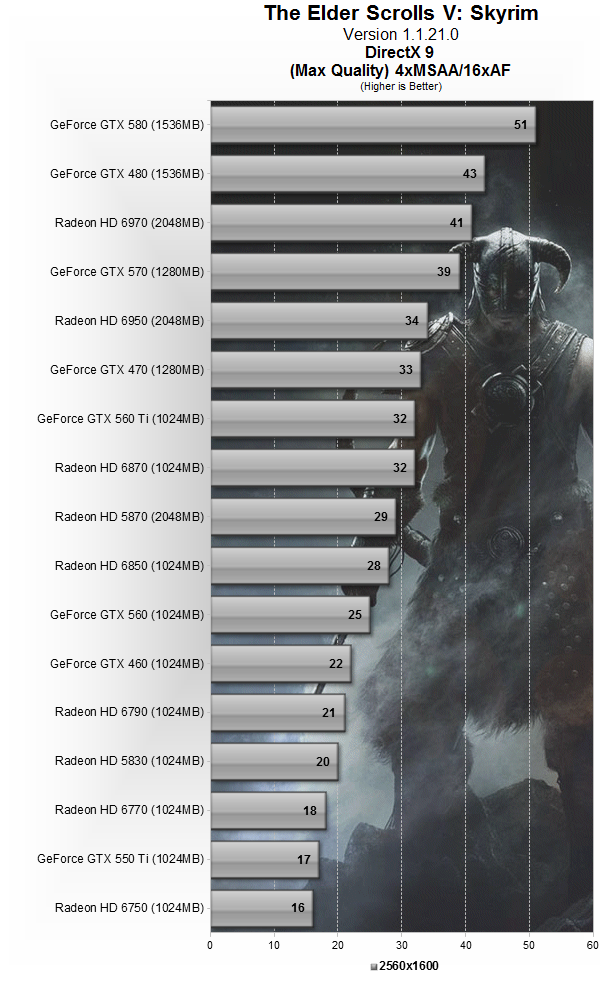

Ok if you want at least 60 fps in SKYRIM at 2560x1600 with 4AA, you'll need at least 2x GTX560 Tis overclocked. A single GTX460 1GB only gets 22 fps with everything maxed at that setting. So even if you overclock a single 460 by 30%, that's only going to get you about 28 fps, so 2 of those won't even get you 60 because SLI scaling is not 100%.

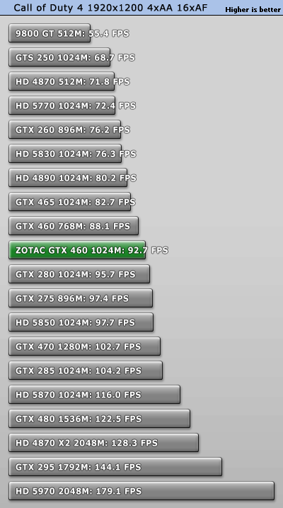

Based on raw performance in dx9,dx10, you could pop each card in , and tell us , which is better stock, single card performance.
Going from results from reviews here, with a gtx460@675mhz(stock), they are about even , single card performance.
From 90fps in COD , to 20FPS in Crysis with AA on.
