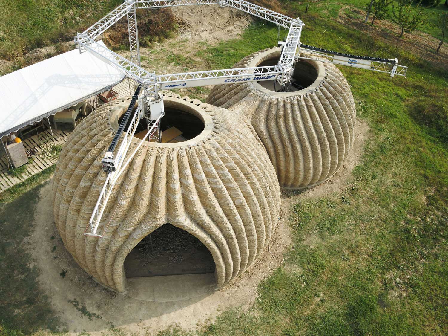

italian company using radial arm printer to make domes.
