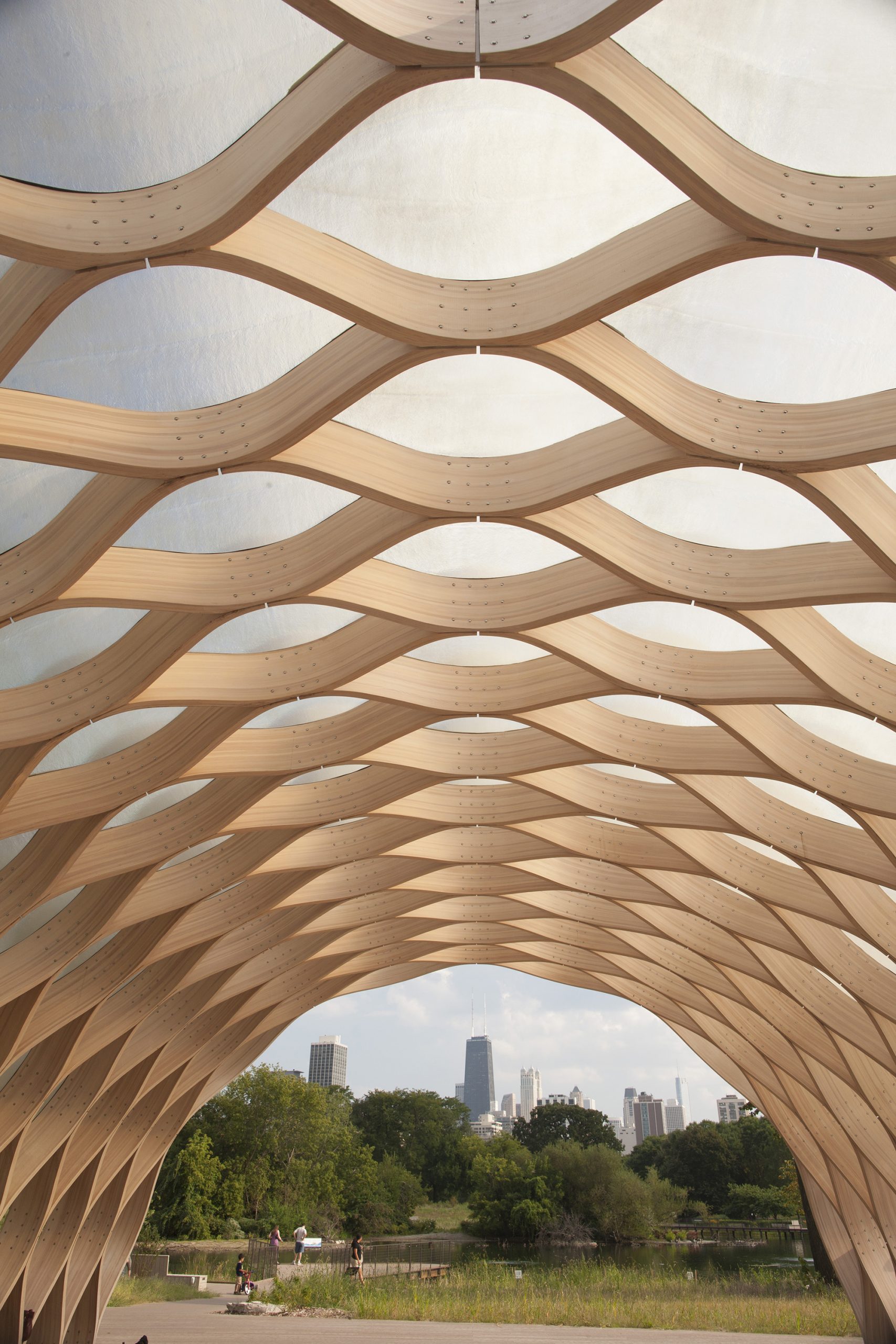

printing makes sense when you dont have abundant timber forests like NA. so this could take off in EU, australia, asia, middle east. But the bigger trend for green housing is Cross Laminated Timber. they want to replace steel rebar and concrete office towers with this stuff.
