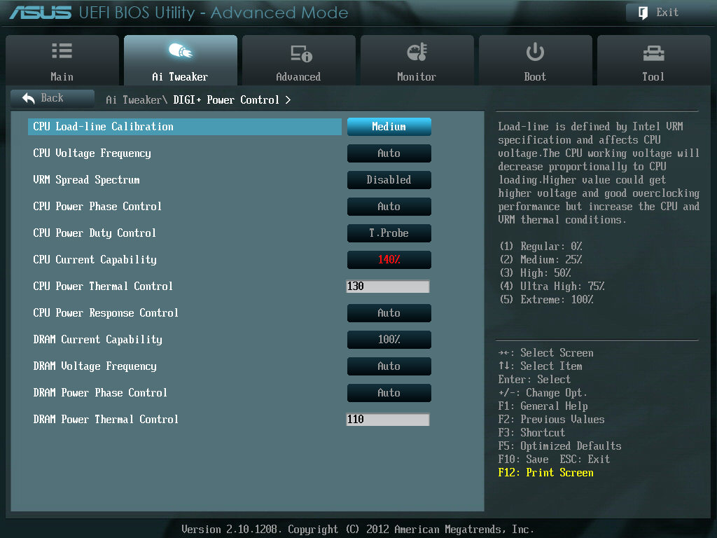

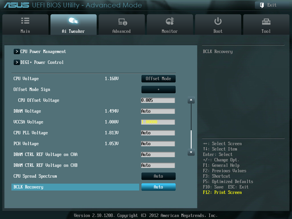

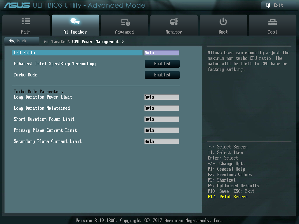

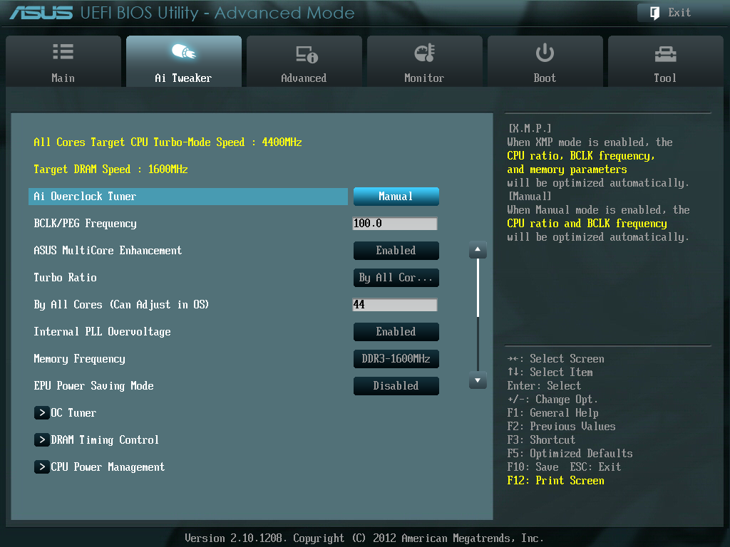

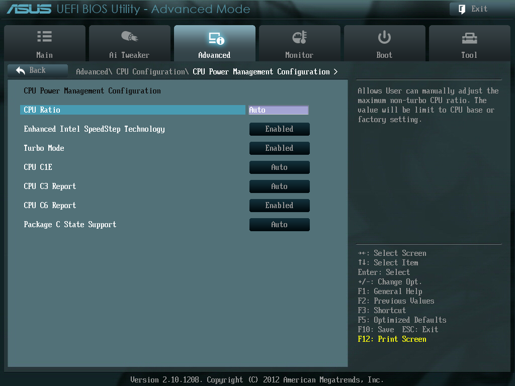

I don't see any settings relating to a turbo voltage. Since the BIOS update, I might be able to be stable at 4.4GHz. Even with VCCSA at 1.0125 (turns red after that), and a +0.035v offset, I still crash at 4.5GHz. Right now I'm testing 4.4GHz with VCCSA at 1.000, and a +0.005v offset.
http://replica9000.bizland.com/other/random/asus/150129174507.BMP
http://replica9000.bizland.com/other/random/asus/150129174514.BMP
http://replica9000.bizland.com/other/random/asus/150129174535.BMP
http://replica9000.bizland.com/other/random/asus/150129174544.BMP
http://replica9000.bizland.com/other/random/asus/150129174641.BMP
http://replica9000.bizland.com/other/random/asus/150129174658.BMP
