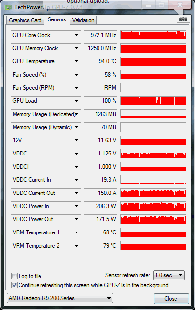

----Results----
I ran the Unigine Valley benchmark and let it loop for about 20 minutes during each run to make sure everything was heat soaked.
Stock cooler, "quiet" mode (40% max fan speed, still pretty loud despite the name)
Notice the substantial underclocking of the gpu:
Stock cooler, "uber" mode (55% max fan speed, very loud)
Notice how the gpu is still underclocking itself a little:
Accelero + heatsinks, custom fan profile to make them spin 100% at full load (pretty quiet even at full load):
Notice the gpu running at the full 1000 MHz:
I haven't done any overclocking tests, as that's not really something I care about at this point. I just wanted something quiet and that kept the card cool enough so it wouldn't underclock itself. This cooler works great for that. It keeps the gpu in the 60s, and it keeps the VRMs well within a reasonable temperature range.
