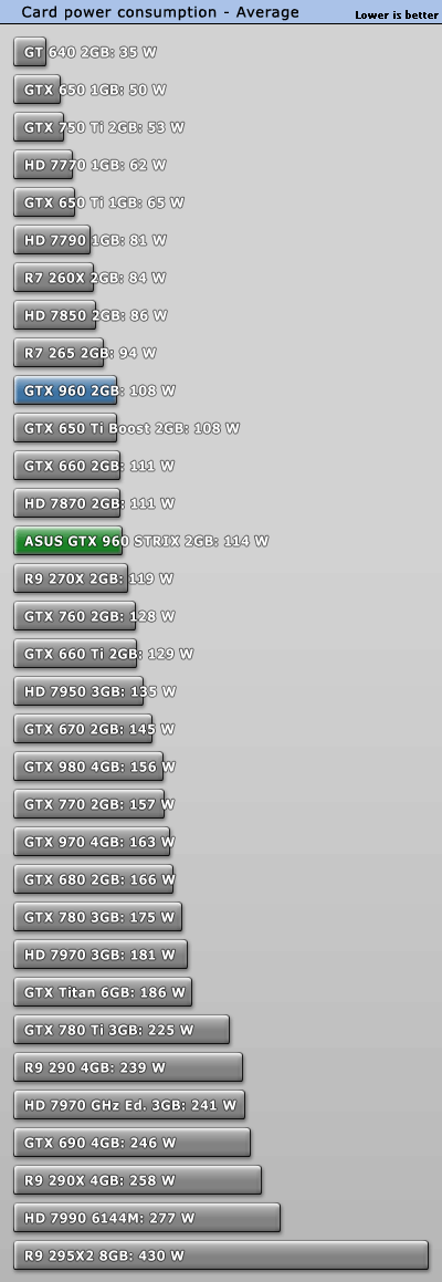

Yep, though a 960 has a typical TDP of 120W while a 980 has a TDP of 165W. The 960 does better comparatively because it is allowed more power (also why it is less efficient).
Set the 960 and 980 so that the 980 is using twice the power of the 960 and see what happens. 960 also seems to run at higher clocks than the 980 as well.
(Fury is more difficult to compare because it uses HBM).
