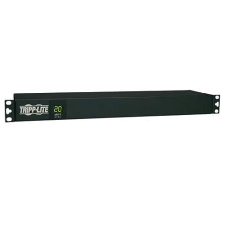

I use one of these guys to manage my server room.
"12 Outlet L5-20P"
http://www.amazon.com/Tripp-Lite-PDU...ed+power+strip
These guys are then connected to that top guy:
PDU's aren't surge strips. You will need a UPS back-ending it.
+1 PDU's arent surge strips...
