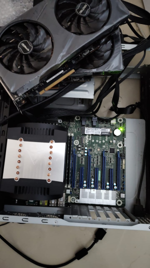

Installed the two cards. Debug LED gets stuck at 94 which means card not recognized. Except on the 8th or 9th power cycle, it did get into Windows, installed the drivers and both cards were visble as OK in Device Manager. The driver installer recommended a reboot and now I'm back with the code 94. Any tricks to get boot working reliably?
Both cards and mobo (Zen 2 Epyc mobo) are ASROCK made. Annoyingly ironic.

I've noticed all kinds of flakiness with multiple GPU's with above 4G decoding turned off. I would try to turn that on (if it's not already) and see what happens. If it's turned off there's not enough PCIe resources to fully allocate to the GPU's, so maybe the one time it booted you lucked out and maybe it disabled your onboard NICs or something and allowed it to boot. Hard to say but that's definitely the first thing I'd check with the symptoms you're describing.

I would try the cards in a different system just to make sure they work reliably. Outside of that, I am assuming this is the EPYC8D or ROMED8 board you're using. Both of which I have and I've got 2 - 7 GPUs in mine. Do you have a PCIe power connected to the motherboard's PCIe power plug on the other side of the PCIe slots? Also I would disable discrete video output in the BIOS and let the video output go to the BMC. You'll need to either use a VGA cable to plug your monitor in or get the BMC/IPMI IP address and remotely login to the host on another computer.
Also the BMC/IPMI logs might give some insight on what's going on.

You have the EPYCD8 model.
Yes, the riser cards are a #$$@# as some of them don't work when you get them. Testing them all takes a lot of time.
Getting the cards to show up on a couple hosts I ran into issues, but usually solved them by changing different things. From 4G encoding, virtualization crap, legacy boot crap and changing the PCIe gen version.
In fact, now that I think about it. I think that might be your problem. I think those are Gen4 cards. Try changing the PCIe Gen to Gen3. They're probably on auto right now.

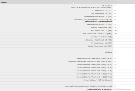

Go here to configure what tasks you download:
Your Account ..> PrimeGrid preferences

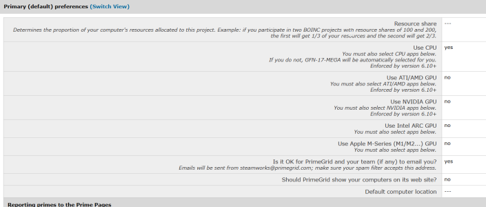

Here, you want to keep resource share at 0 (or blank like the screenshot)
Turn 'Use CPU' to no
Turn ATI/AMD GPU, Nvidia GPU, Apple M-series... GPU, to no. (Optional, they're not in the system so it wont matter really.

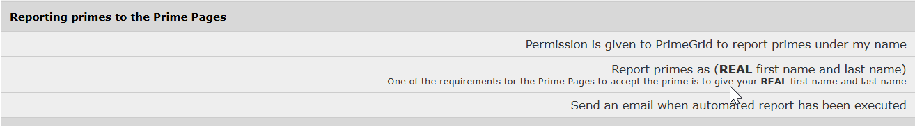

Make sure you fill this out correctly. If the testing does happen to turn out to be a prime you'll get an entry on the top 5000 primes web site. (optional, but recommended)
In this screenshot you see I am running PPS and PPSE on CPUs. What you want is to make sure ALL the CPU columns are blank/empty.
Check GFN18 and leave everything blank. Make sure you choose Intel ARC GPU on it. Then when you attach the project it will download a GFN18 task. Let this task run. **
When that task is done. Go back to that page and uncheck GFN18 and select GFN19.
Keep repeating this process for the GFNs.

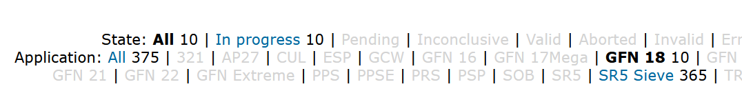

I did all the settings. Some perplexing questions:
There is no account login option in BOINC manager.
It does show my username correctly but it started doing this Serpienski Sieve thing and only one GPU is being used with 1.2GB VRAM utilized. Something seems off I think.
28,173
19,203
I think SR5 was the one running which I suspended. I can't see it on the Project Preferences page to disable it.
