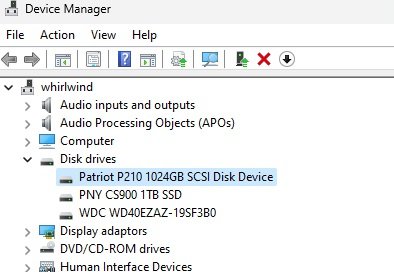

However, the lights on the adapter itself show a tiny blue led where it says "access", but a red light where it says power. I would assume that this seems to be indicating not enough power. In device manager, it seems to be showing up as a SCSI disk drive, which is strange, but at least it is detecting the Brand name and model number, so it sees it.
However, no disk shows up when I go into "this pc"". I do notice that the adapter seems to have a round power adapter hole, probably for adding 12 volts DC power supply. But surely that isn't necessary for such a low power draw SSD?

Give the power port a try? Wait the drive is listed in device manager? Then go to disk manager, you may need to assign drive letter.

Haha! That was it! I had assumed that the red light on 'power' meant that it didn't have enough, but evidently that just showed that it was getting power! I'm in process of doing a slow format to exfat. What would eventually be a good choice for a dual boot Linux and Windows system?

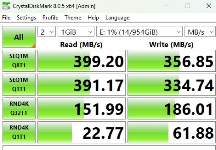

Sorry, it was my first time ever trying to hook up a 2.5" SATA SSD to one of these USB3 to SATA adapters. (I didn't even know such a thing existed until last week) The thing didn't come with ANY useful documentation, so I thought I'd ask on here for suggestions from folks who had experience with them.
Speeds are fairly decent, I guess.

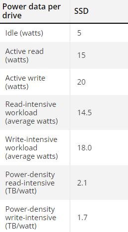

Patriot finally answered my question about the SSD's power draw with the info above. My understanding was that USB 3 offered just 4.5 Watts max power. If the active write takes 20 watts, then how in the world is this thing working well??? They are saying that this thing (P210) uses more than that just at idle......
They must have pulled up the wrong document or fudged a decimal place. Those are power figures for like enterprise class spinners.
