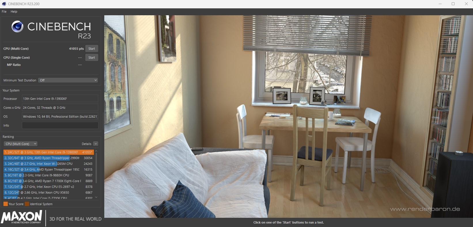

OK I tried the thermal limiting approach instead of the usual power limit approach and I must say, I quite like it. Seems a lot easier than twiddling with the PL values. Did a single test CB23 run to see how much higher a score I could get with unlimited PL and thermal limit set to 90c, and I got 41,055. CPU maxed the P cores at 5.5ghz and the E cores at 4.3ghz for the first with no throttling, which generated the 41,055 score, the highest I've ever had. Then I did a multiple back to back runs to test how much the CPU would throttle when put under prolonged load, and it honestly didn't throttle that much. It hit a max of 91c then dropped down to 5.4ghz on some of the P cores, but was still hitting 5.5ghz on a few of them so the algorithm is very good for thermal limiting. The highest the power draw was during the CB23 run was 263w or so.
I also lowered my undervolt from 135mV to 115mV. Not sure if I'll keep these settings though, because I don't really gain much performance at all due to running at 4K. Then again, gaming power draw is so minimal that it probably won't matter as I never get anywhere near the 90c limit. I'll have to try some encoding tests.
Wow! You've got a sweet setup. When running CB 5.5/4.3 what are your VID and Vcore average values?
At 5.5ghz, the average was 1.274v. I can only fully sustain 5.5ghz for about 2 runs before it starts to throttle though, then it will mostly be at 5.4 and 5.3ghz.
Not really a problem though, because CB23 isn't a workload that I ever do 😉
Correction, the Vcore during the run was 1.2v. HWinfo doesn't report accurate Vcore values from what I've seen. CPU-Z is more accurate, because when I change the voltage settings in the UEFI, CPU-Z registers the change unlike HWinfo.
What was the reported VID when the Vcore was 1.2? Crazy that your chip can do 5.5 Vcore 1.2.
During those two runs where it was holding 5.5/4.3 what was the package power?
Sorry, the terminology had me a bit confused. After doing some googling, VID is what the CPU is requesting correct? And Vcore is what is being delivered?
I took a screenshot and I think my VID was 1.278v, while the actual Vcore was 1.163v. Package power was in the 270w range.
Jeez, those are some great numbers. I'll post mine for comparison purposes. I don't see Vcore listed in your HWinfo? I hate to keep bothering you but what was that reading as compared to CPUz?
