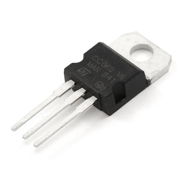

Get a 6V voltage regulator that can handle 12V input and the amount of Amps the lights need, this one is just an example, the first result that showed up on google.
The datasheet shows that it can handle up to 18V input and it handles 1.5A output, it also shows you the application circuit, as in what capacitors to put on the in and output.

Yes, a Voltage Regulator built using such devices is relatively simple to build and MUCH easier to use because it can handle some range of load. Resistors need careful design and can NOT adjust to load changes.

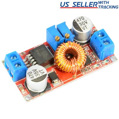

Current consumption would be good to know too, as it lets you know how small a buck regulator you can use. There are some tiny ones costing under a buck a piece in bulk, and others a little higher powered but still pretty small. I will link to the latter as these are some I have used before, nothing fancy but sometimes you don't need continual pushbutton changes, nor an LCD display at extra size and cost:
You'd take the output from those, as the input where the batteries connected to the light, not trying to direct drive the LEDs arrays with them. That "might" work too if it they just use a series resistor built-in for current limiting but this is unknown without some reverse engineering of the light. Above linked regulators are small enough that they "might" fit in the area that the removed batteries leave behind. Again, need to take the light apart to see what you're dealing with.
No, 25ft of 14awg would not have created enough voltage drop, on the contrary it seems like a fine gauge to use from the battery, to the linked buck regulators above, to do this. It is assumed you realize that you need to adjust the buck regulators to the target voltage (measure what the charged battery in the light reaches, not just 6V since IDK where you got 6V from), measured with a multimeter, before powering the light, then if there's a little extra voltage drop, can fine tune it from there.

Stepdown converter like mindless1 links.
You just put it between the battery and light.
