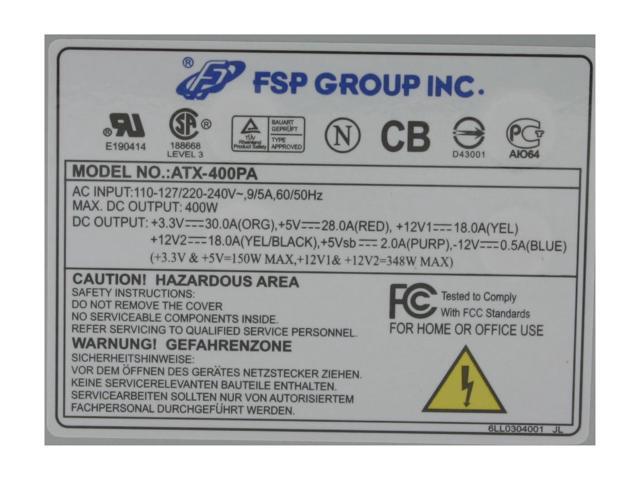

Originally posted by: Harvey
The answer is a qualified "yes." Your PSU is spec'd with two separate 12 volt rails. One can supply circuits requiring a total of 14A, and the other can supply a total of 15A. That's a total of 29A, but neither line can supply more than its rated load.
That is incorrect. Rails are not additive. Each rail, added to the next often exceeds the actual output capability.
This is because, as Marc suggested, they take the +12V rail, split it into two circuits and just put a "limit" on each circuit that prevents no more than a specified amount of current to be delivered to a connector.
To find out how much +12V your power supply really has, you need to find a wattage number under neath the two +12V rails or some verbiage that says something like "combined +12V shall not exceed...."
Take this FSP for example:
http://images10.newegg.com/New...mage/17-104-952-03.jpg
It says +12V1 is 18A and +12V2 is 18A. That's 36A, or 432W! 432W? That's greater than the actual capability of the PSU!! If we look down at the last line, it says the +12V1 and +12V2 is 348W.
What that means is, you can put 18A on one rail, or 18A on the other, but not 18A on both. If you put 18A on one rail, that only leaves 11A available to the other because the maximum +12V output is 348W.
For your FSP to have only 14A and 15A means it's pretty old. The FSP 400W units I could find all had more. I wouldn't suggest it for your build, but if you already have it, you might as well try it. And if the computer keeps shutting down or locking up, suspect the PSU first.
