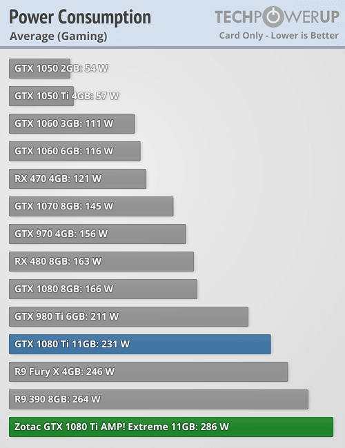

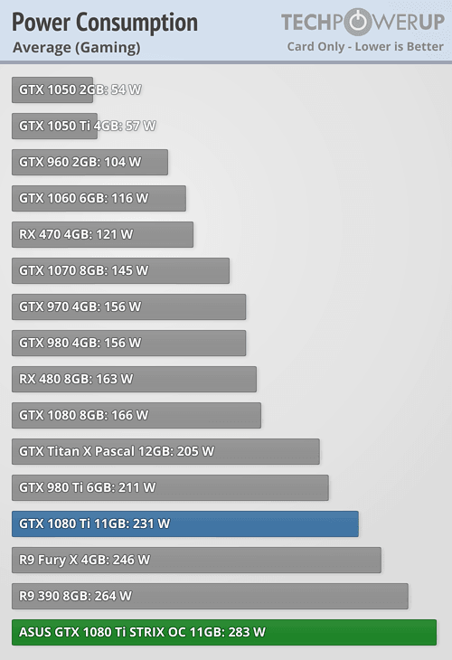

Also the 1080 Ti does appear to use more power
Custom 1080 Ti's can use a lot more power
vs your Evga 980 Ti:
So you are putting an extra ~50w of heat in your case now from the GPU alone.
