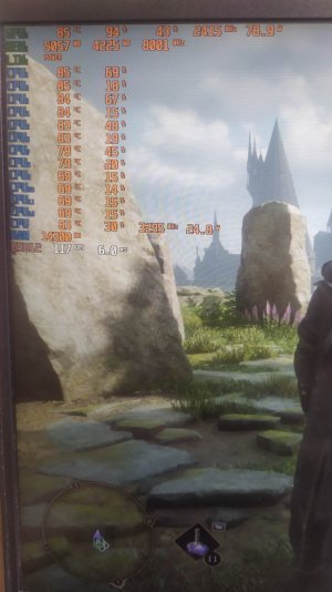

Hello friends, I have a laptop with an i5 12450h processor, and its temperature started reaching 95-100 degrees under load. I could clean the fans and replace the thermal paste to lower it, but I don't want to void the warranty.
Instead, I found a program called QuickCPU and reduced the turbo long power max to 25W, and turbo short power max to 35W. I also set the maximum allowed performance to 80%.
Default setting is turbo long power = 45w, short power 120w.
Currently, the processor runs at 3.6 GHz and the temperature is 80 degrees during gaming. Only the FPS dropped a bit.
My question is, will these settings damage the processor?

Hello again, sir. This is the situation after the latest settings. Normally, it goes up to 4.4 GHz with turbo boost, but right now I've only set the turbo long power max to 25W and the turbo short power max to 34W in the quickcpu program. I haven't changed any other settings.
This performance is sufficient for me at the moment. There won't be any issues, right?
